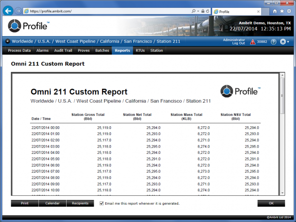

A custom report is a spreadsheet style report with the report collected over a given period of time e.g. a day, week, or month. Up to 16 fields can be added to the report. The report will display data for each field based on the collection period of the server, e.g. a daily report on a server that collects data hourly will have 24 rows of data, with a row per hour.
Profile will print the report in portrait mode if the report has 8 or less fields on it. If there are more than 8 fields it will switch the report to use landscape mode. All custom reports are generated as a PDF document.
Note: This is when the report is generated (i.e. printed) and not the data collection period.

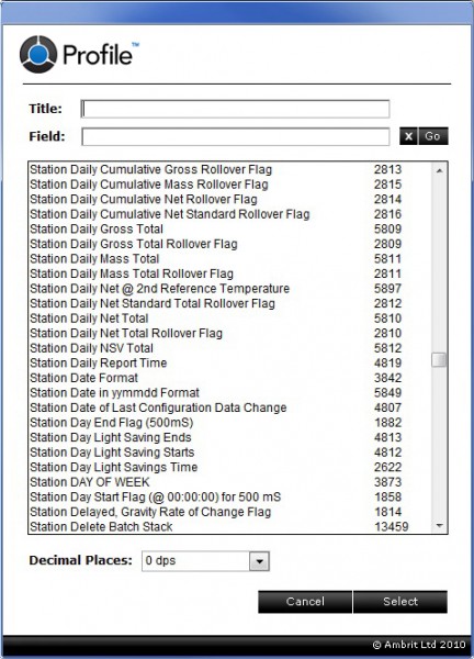

This screen will show all the fields in the RTU.
| Title | This is the name for the field that will be displayed on the report. If a title is not entered it will default to the RTU field name. |
| Field | This field contains the name of the RTU field whose value will be displayed on the report.Tip: Entering a portion of the field name and then clicking the ‘Go’ button will search the RTU fields for matches. Entering the Modbus address will also go straight to that field. |
| Decimal Places | This popup menu defines the number of decimal places that the value will be displayed with. |
