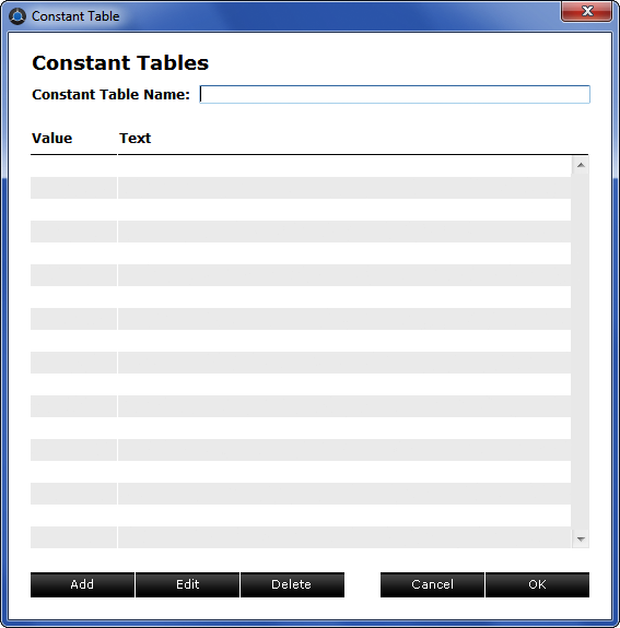

A constant table lets values be mapped to corresponding text strings, e.g. 1 = “START”, 2 = “STOP” etc. When a constant table has been defined for a field, Profile will automatically replace the numeric value with its text equivalent whenever the field appears on a screen or a report.

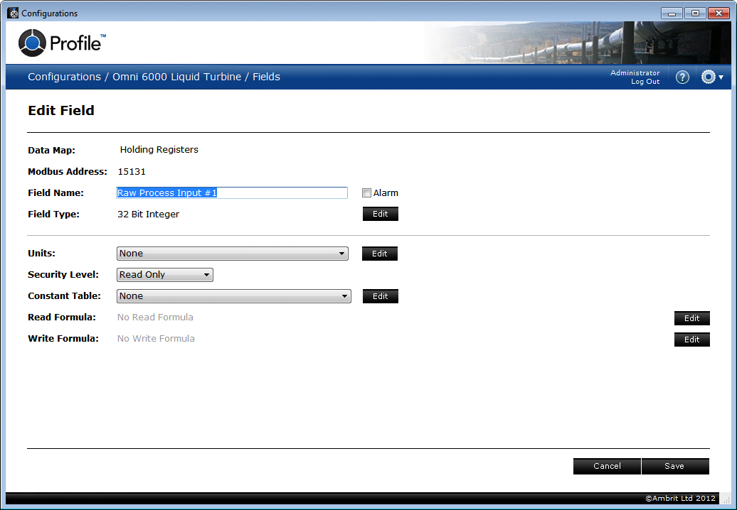

See the Adding a Field to a Configuration section for more details.
If it is an existing constant table, skip to stage 10.

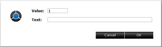

If it is a new constant table then the following dialog box will be shown:
Tip: Values do not need to start from 1. Any number can be used.
Tip: Values do not need to be contiguous. If values don’t exist in the constant table then the numeric value will be displayed instead.
This will return to the Edit Field screen.
