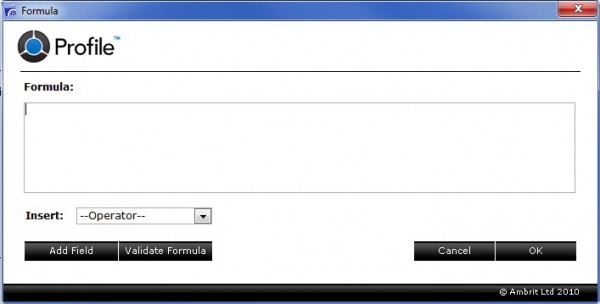

Fields can have formulas associated with them to allow simple arithmetic functions to be applied before they are displayed or written to.
See the Adding a Field to a Configuration section for more details.

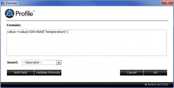

Formulas have the following syntax:
value:=expression
where expression is a mathematical formula, e.g.:
value:=9*4

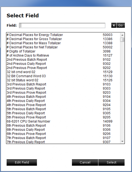

Any field from any of the RTU can be selected and can be included in the calculation, e.g.:
value:=field("Pressure")
Multiple fields can also be included in the calculation, e.g.:
value:=field("Net Flow Rate")-field(Gross Flow Rate")
Variables can be declared and used as part of the calculation, e.g.:
var a := 2; var b := 3; value := a + b;

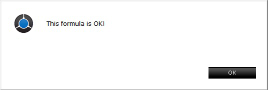

“value:=value/100″
If the formula is entered correctly a message will be displayed saying “This formula is OK!”.
