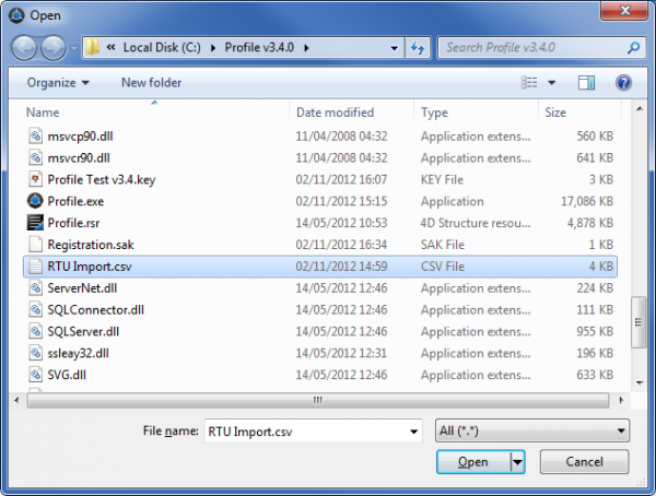

Although it is possible to individually add each RTU into Profile, RTUs can be easily added by importing them from a file. This file will also create all the areas and the stations too if necessary.
Importing RTUs must be done on the server.
The RTUs will be imported into the system.
The file format is as follows:
