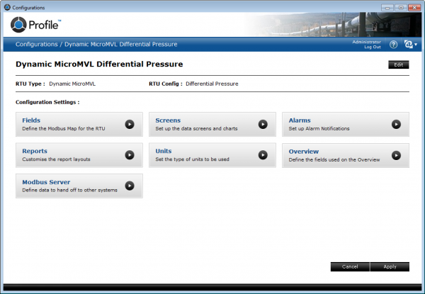

Each configuration has its own Modbus map. This map will automatically be extrapolated for each RTU on the system See here for more information.
Note: The Modbus Server configuration setting panel is only available if it has been enabled in the server licence.

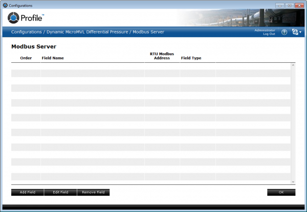

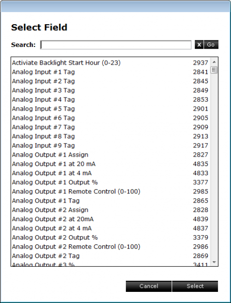

This will open a window that contains all the fields in the configuration.

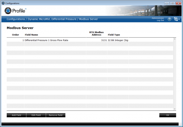

The field will be added to the list.
Tip: The fields can be repositioned by dragging and dropping them in the list.
The Modbus server map changes will be applied to every RTU using the configuration.
Note: The entire Modbus map can be seen in Modbus Server screen.
