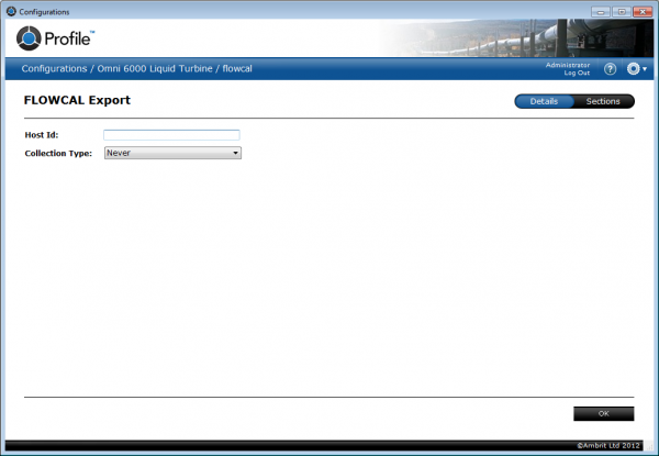

| Host ID | The Host ID is the name to identify the Profile server. |
| Collection Type | This determines when the CFX file should be generated. By default it is set to “Never”.Options are “On Batch End”, “Hourly” and “Daily”. |

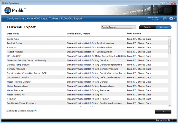

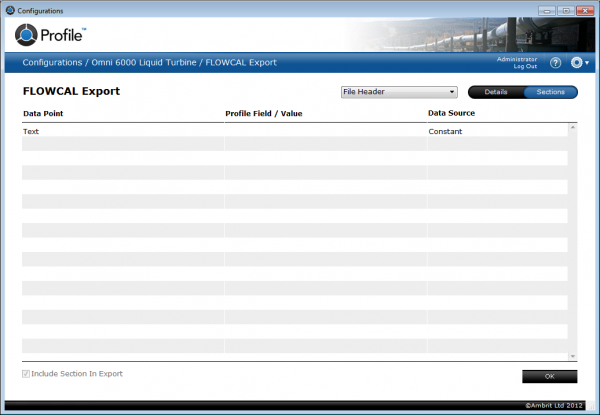

There are 6 sections available:
These sections are all defined in the CFX Format v7.05 document.
Selecting a section from the popup menu will show the fields that are required for that section.
Every FLOWCAL field in the section is shown in the list. These must be mapped to fields in the RTU.

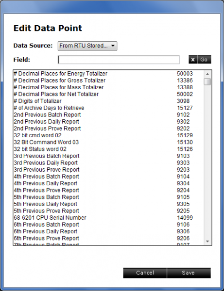

| Data Source | Each field can get its value from one of the following data sources:From RTU: These fields are downloaded as live values from the RTU when the CFX file is generated.From RTU Stored Data: These fields are retrieved from either the batch data or the historical data when the CFX file is generated.Constant: This is a value that will never change.From Station Data: This is a value that needs to be configured on a station by station basis. It is set in the station screen. |
| Field | This field in the RTU that will be used to gather the data. This field is only required when the data source is “From RTU” or “From RTU Stored Data”.Tip: Entering a portion of the field name and then clicking the ‘Go’ button will search the RTU fields for matches. Entering the Modbus address will also go straight to that field. |
| Value | This field stores a fixed value. The value is only used when the data source is “Constant”. |
