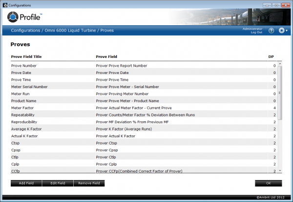

When a prove completes Profile will download the prove data and save it into a CSV file.
Note: Proves are only available if they are part of the server license and supported by the RTU.
Omni: Ensure that this information is also recorded in the archive of the Omni otherwise the data will not be stored.

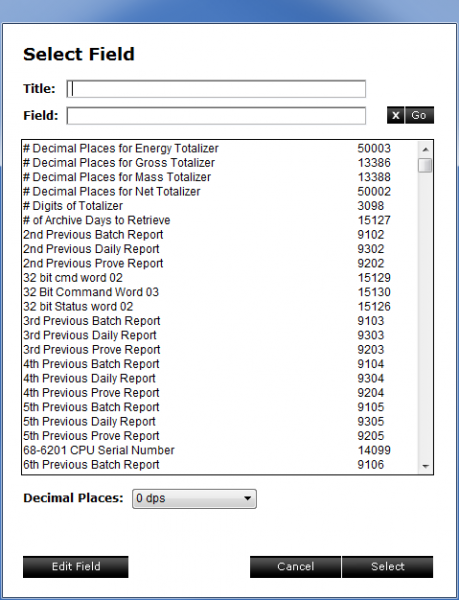

Tip: Entering a portion of the field name and then clicking the ‘Go’ button will search the RTU fields for matches. Entering the Modbus address will go straight to that field.
This needs to reflect the display order and the order they should appear in the CSV file.

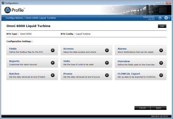

This will return to the main configuration page.
This will make the configuration changes active.
See the ‘Setting Profile Preferences‘ section for more details.
