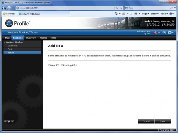

See the ‘Adding an RTU‘ section for more details on how to add the RTU.

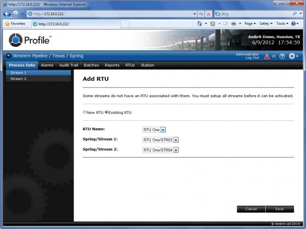

Because the RTU has some spare meter runs, Profile asks whether an existing RTU should be used or if a new one should be created.
Profile will display a list of all RTUs for that area that have unallocated meter runs.
The RTU will now also be associated with this station. This means that any alarms, audit trail or reports etc will be shared between the stations.
