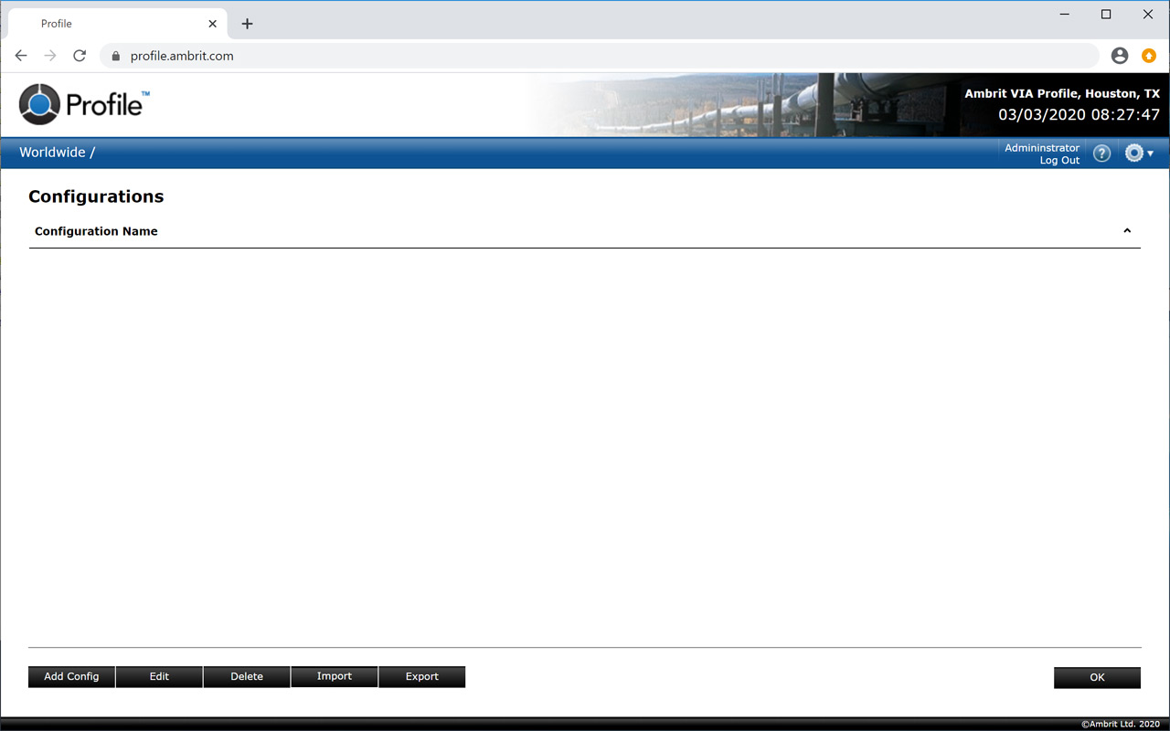

The Configurations List is displayed:

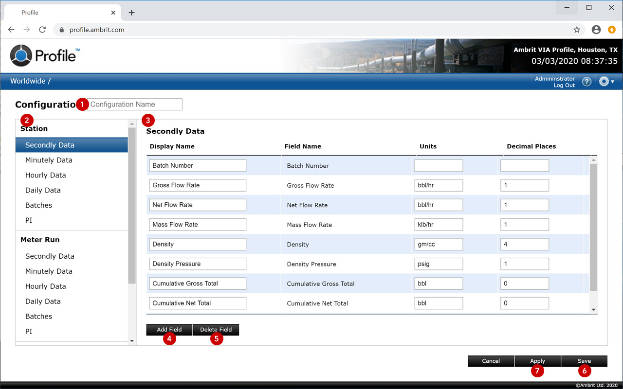

The configuration editor is displayed:
The left hand sidebar 2 shows the list of available sections.
The right hand panel 3 shows the set of fields associated with the selected section. A set of default fields is provided for each section but these can be edited as required (see below).
N.B. For mandatory fields, the Field Name will not be editable.
To add a field, click the ‘Add Field’ button. If there is not a row selected, the new field will be added at the top of the list. If a row is selected, the new row will be added immediately above the selected row.
To delete a field, select its row in the list and click the ‘Delete Field’ button.
To reorder fields, drag and drop them to a new position in the list.
N.B. Click the ‘Apply’ button to save the changes without returning to the Configurations list.
