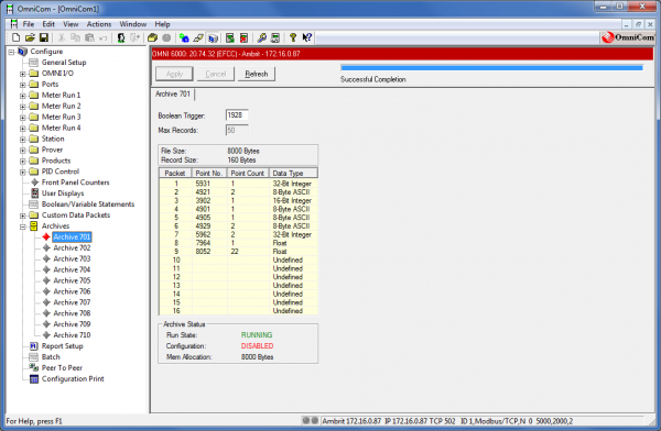

Profile is designed to run out of the box with all natively supported RTUs. However to take full advantage of some of the features that Profile provides, extra setup work must be carried out on the RTU itself.
Note: The Prover Prove Report Number field must be in the first packet.
| Packet | Point No | Description | Point Count | Data Type |
| 1 | 5931 | Prover Prove Report Number | 1 | 32 Bit Integer |
| 2 | 4921 | Prover Prove DateProver Prove Time | 2 | 8 Byte ASCII |
| 3 | 3902 | Prover Proving Meter Number | 1 | 16 Bit Integer |
| 4 | 4901 | Prover Prove Meter – Product Name | 1 | 8 Byte ASCII |
| 5 | 4905 | Prover Prove Meter – Serial Number | 1 | 8 Byte ASCII |
| 6 | 4929 | Prover Previous Meter Factor DateProver Previous Meter Factor Time | 2 | 8 Byte ASCII |
| 7 | 5962 | Prover Previous Meter FactorProver Previous Meter Factor Time – Current Prove | 2 | 32 Bit Integer |
| 8 | 7964 | Prover K Factor (Average Runs) | 1 | Float |
| 9 | 8052 | Prover Average Meter Temperature of RunsProver Average Meter Pressure of Runs Prover Average Prover Temperature of Runs
Prover Average Prover Pressure of Runs Prover Average SG60/Density@Ref.T of Runs Prover Average Proving Meter Flowrate of Runs Prover Counts/Meter Factor % Deviation Between Runs Prover Ctsp Prover Cpsp Prover Ctlp Prover CCFp Prover Corrected Prover Volume Prover Proving Meter Volume Prover Ctlm Prover Cplm Prover CCFm Prover Corrected Meter Volume Prover Average Counts * LCF Prover Actual K Factor Prover Average Proving Meter Flow Hertz |
22 | Float |
These fields must correlate with how Profile has been configured.
