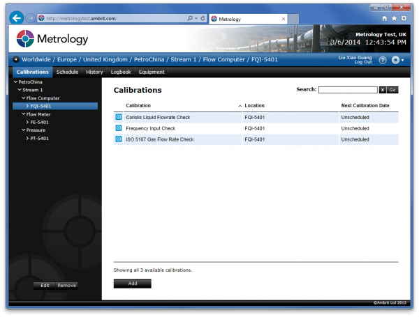

1. Select the equipment in the Inventory Menu
The list of existing calibrations will be displayed:
Screen Shot 2014-03-06 at 12.43.52
2. Click the ‘Add’ button

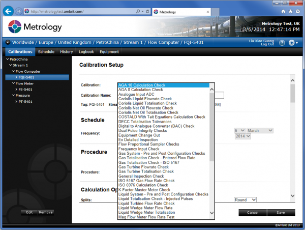

The Calibration Setup screen will be displayed.
The types of calibration available will depend on the type of equipment selected. Examples are shown below:
Flow Computer
Calibration Setup Flow Computer
Flow Meter
Calibration Setup Flow Meter

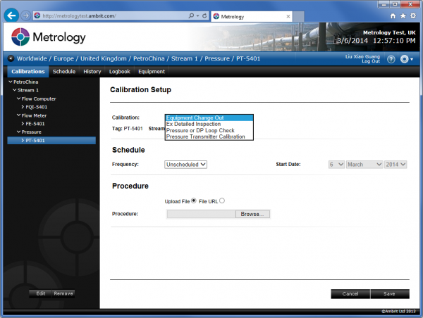

Pressure
Calibration Setup Pressure
