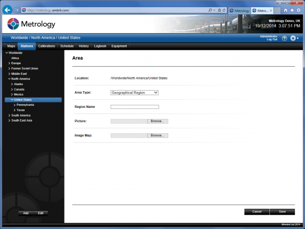

1. Edit an area
2014-12-19 15.07.52 Screenshot

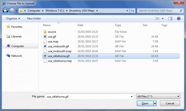

2. Click the ‘Browse’ button next to the ‘Picture’ field
Screen shot 2010-04-02 at 09.47.03
3. Select the picture file.
Note: This should be a JPEG or GIF file.
4. Click the ‘Open’ button

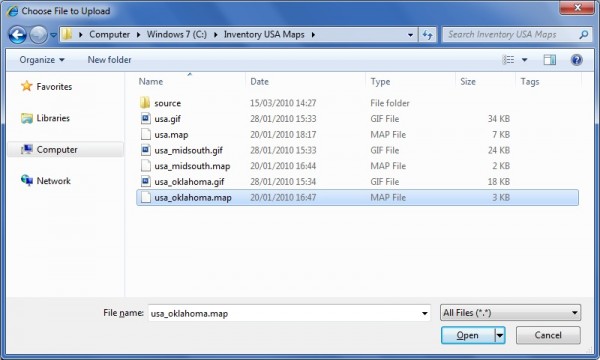

5. Click the ‘Browse’ button next to the ‘Image Map’ field
Screen shot 2010-04-02 at 09.47.07
6. Select the image map file
This should be a text (.txt) or map (.map) file.
7. Click the ‘Open’ button
