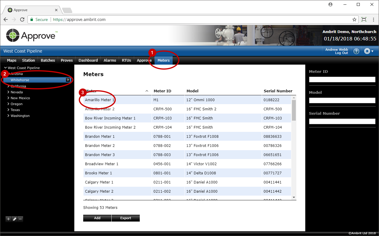

1. Click the ‘Meters’ tab in the Database Bar 1
2. Select the station in the Inventory Menu 2
3. Select the Meter in the Meters List 3

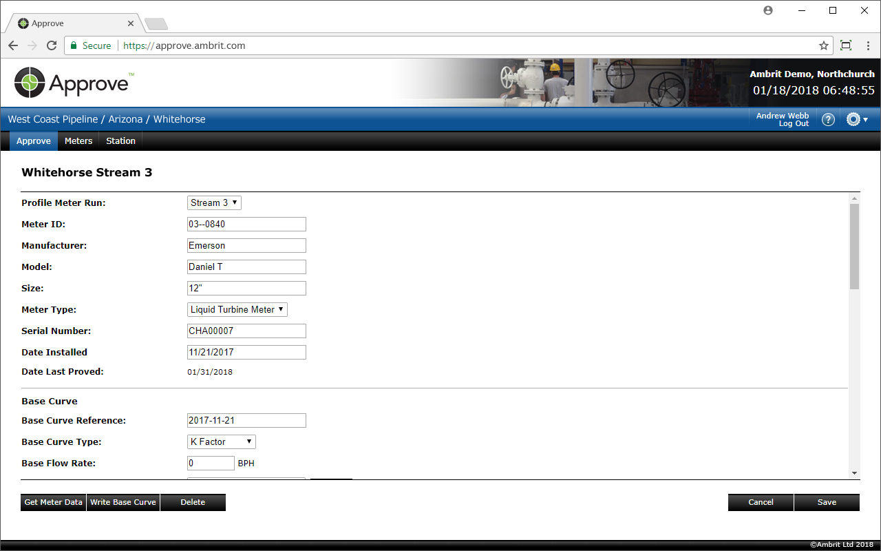

The meter details screen will be displayed:
Approve Meter Details
N.B. You must have “Edit Meter” access level to edit a meter. Warning: Updating a meter will cause Approve to recalculate all prove data for the meter’s current base curve. This may affect the pass/fail status of the recalculated prove data.
4. Update the values that need changing
5. Update the base curve if required
N.B. If you would prefer to use the Base Curve K-Factor and Frequency points from historical accepted prove data, rather than the data from the flow computer, select a a curve type from the ‘Generate Base Curve’ popup menu and click the ‘Generate’ button.
generate-base-curve-menu
The base curve table will be populated with data based on the curve type selected and the base curve will be displayed on the chart. N.B. This base curve data will only be available within Approve. To implement the new base curve in the flow computer, click the ‘Write Base Curve’ button.
