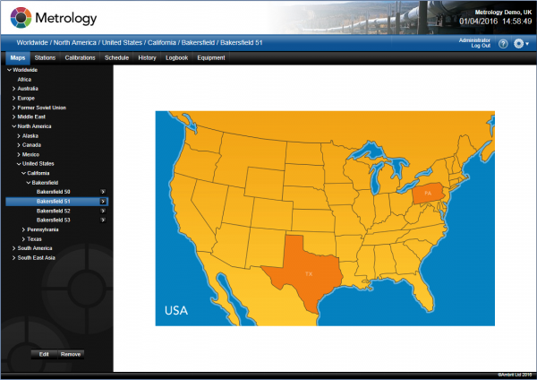

2. Click on the station’s parent area in the inventory menu
screenshot 010416144321

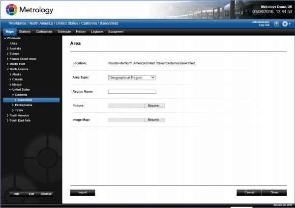

3. Click the ‘Add’ button
This is located at the bottom of the inventory menu. This will open the page as displayed:
screenshot 010416144454

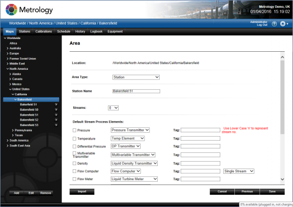

4. Select ‘Station’ from the ‘Area Type’ popup menu
screenshot 010416151558
5. Enter the ‘Station Name’
6. Click the checkboxes of the ‘Default Sections’ accordingly
screenshot 010416144620

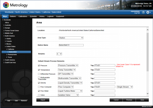

8. Select the number the of streams from the ‘Streams’ popup menu
9. Select the ‘Default Stream Process Elements’ by clicking the correct checkboxes
10. Select the equipment type from the popup menu for each selected process element
11. Enter the tag names for each of the selected process elements
NOTE: Use lower case ’n’ to represent the stream number
screenshot 010416145705
12. Click the ‘Save’ button
NOTE: If there are more screens, continue clicking the ‘Next’ button and repeat steps 5-11.
screenshot 010416145850

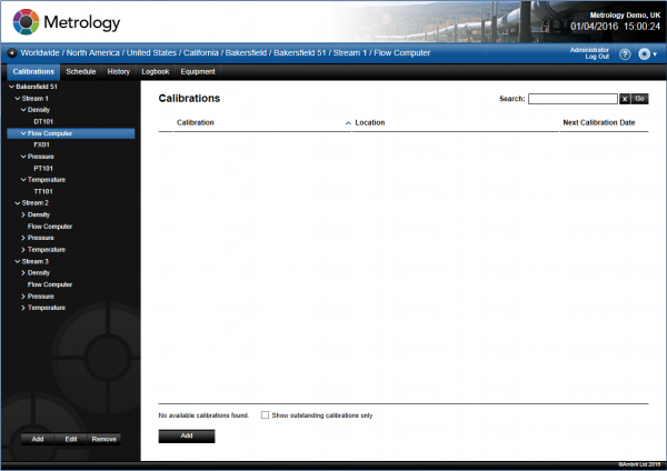

13. Double click on the new station
Metrology has created all the tags for each meter run
screenshot 010416150026
