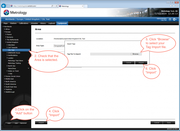

Create a new area in your inventory menu, where you want to import.
Import1
Select the area just added, then import the tag file you have created.
Import2

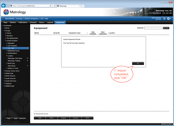

Check that the file has imported ok. Any errors during the import will be displayed here.
Import3

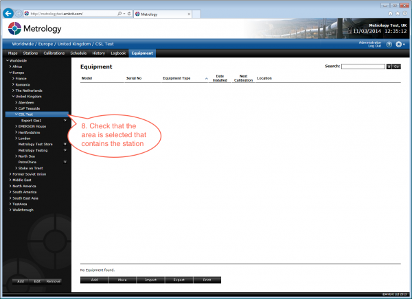

The tag file is now imported, all the tags and locations are now present in Metrology. We can now import the equipment file that will add the equipment to those tags. First, select the area created originally for the import.
Import4

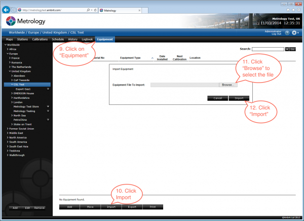

Click on the Equipment, then follow the steps to import the equipment file.
Import5

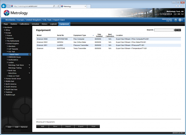

When the file has imported, you will be able to see the equipment records in Metrology. Any errors during the import will be shown. These are commonly, duplicate serial numbers or inventory type names that are not valid or used in the wrong context. (Check the inventory types spreadsheet, referred to above.)
Import6
