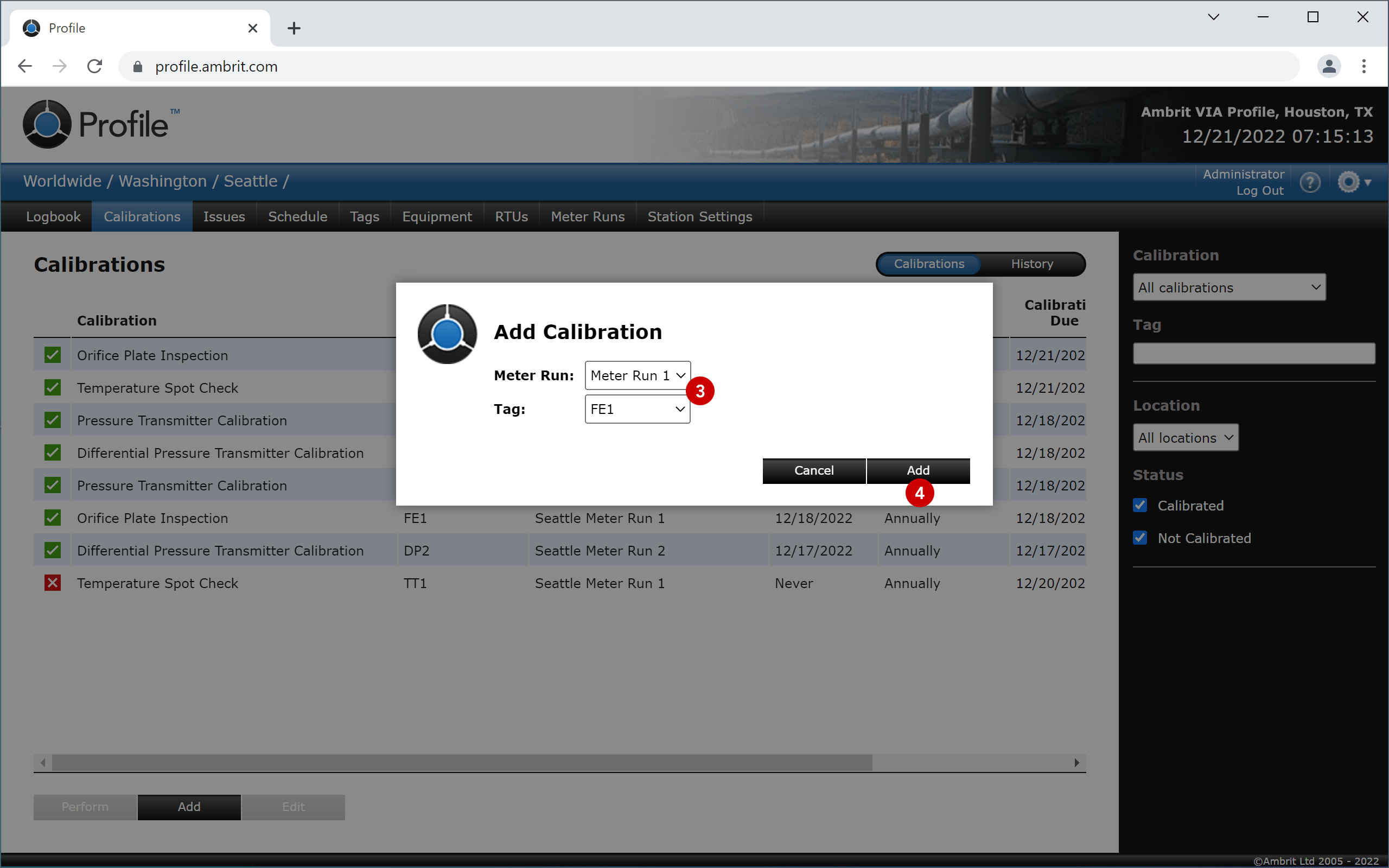

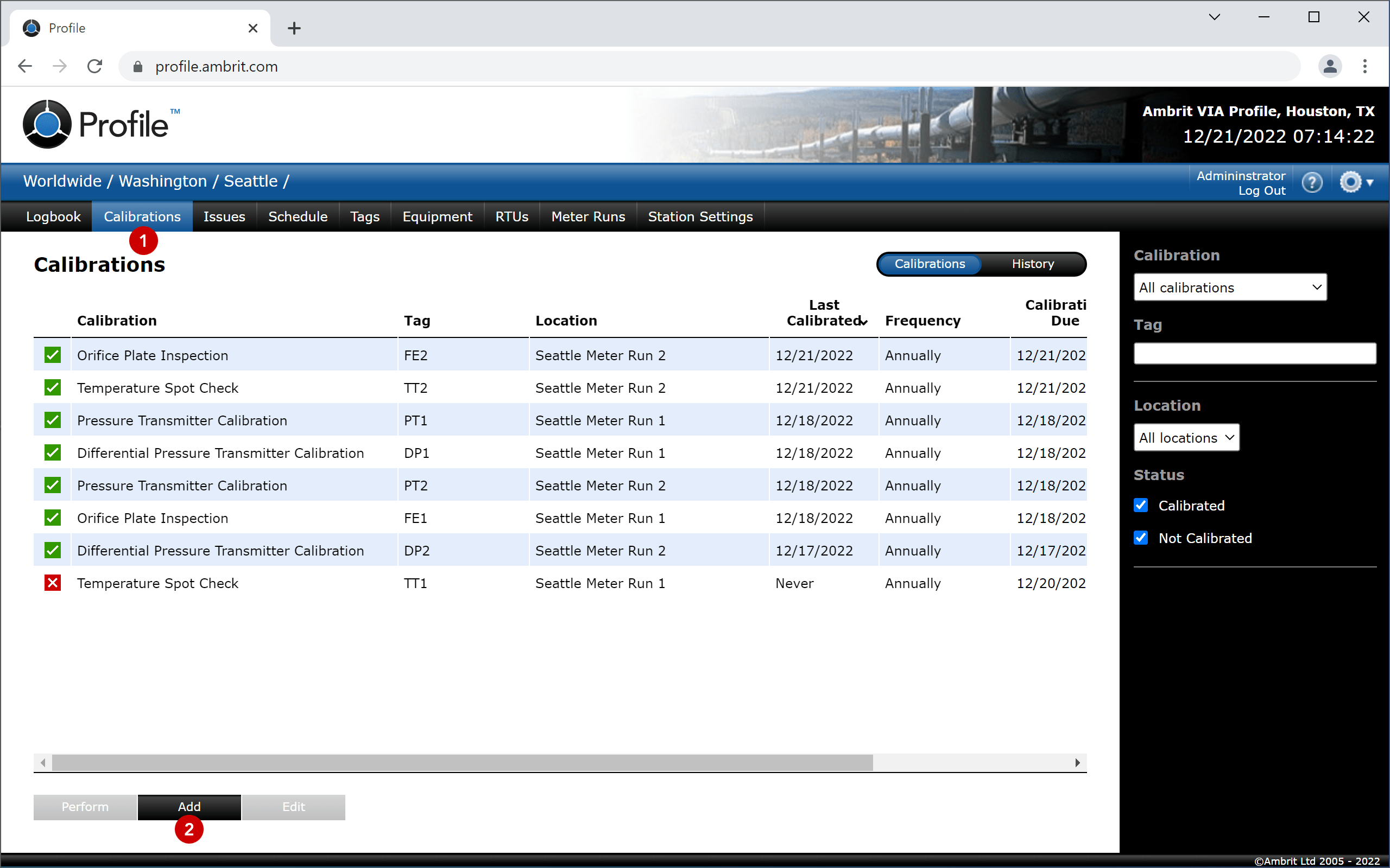

The Calibrations list will be displayed:
The Add Calibration window will be displayed:

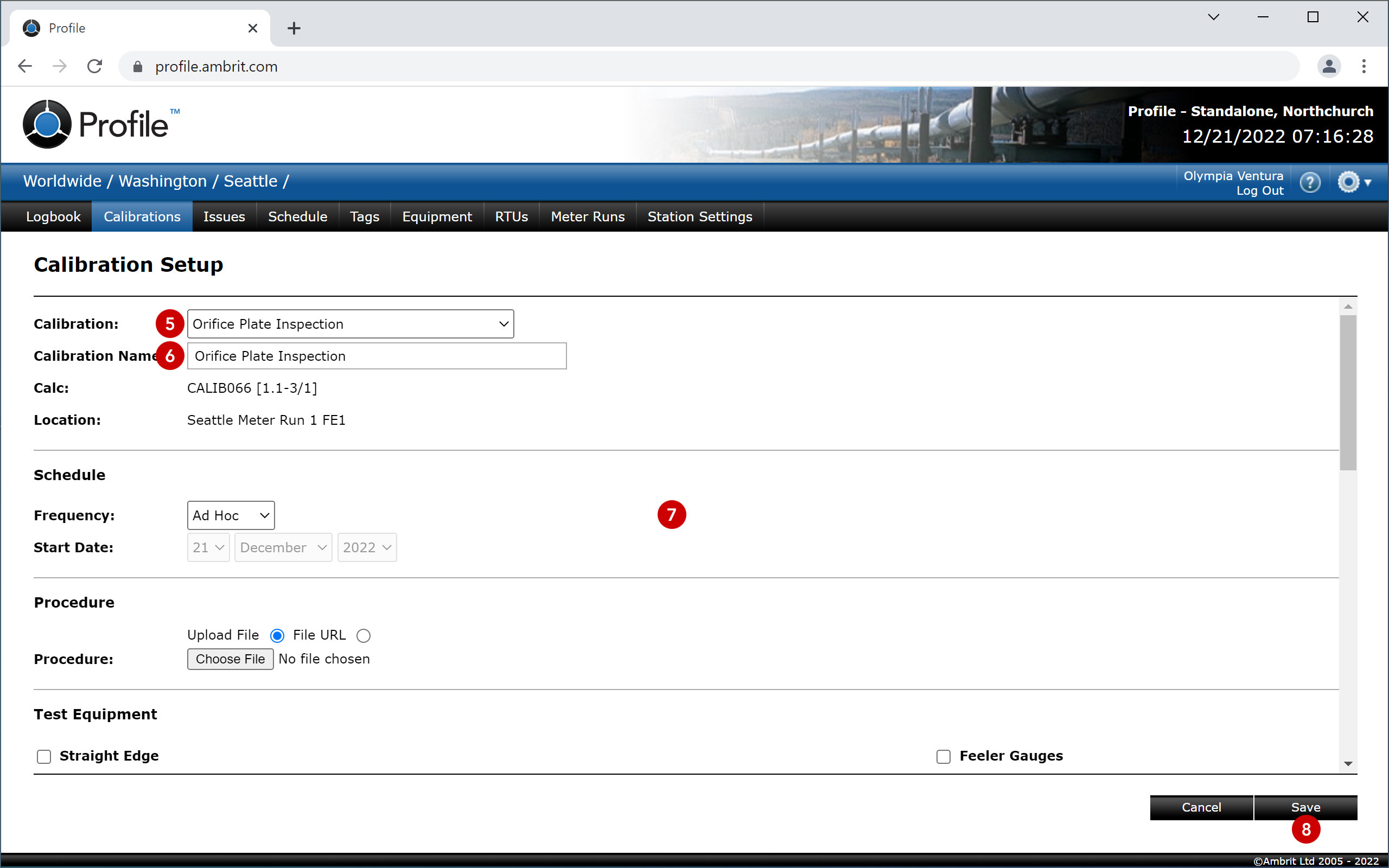

The calibration setup screen will be displayed. The Calibration drop-down menu 5 will include all the calibration setups that match the equipment type associated with the selected tag.
