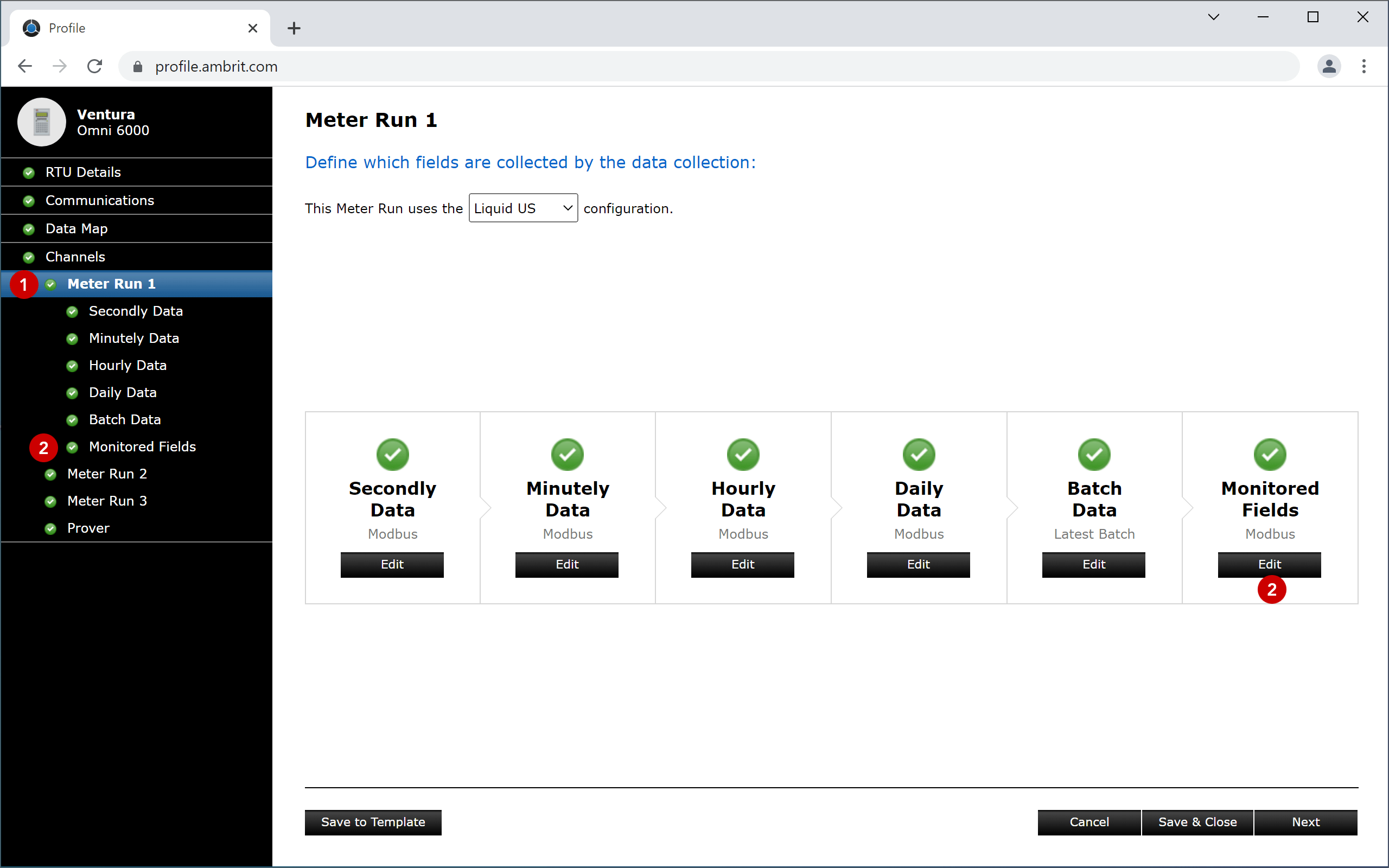

See the ‘Managing RTUs‘ section for more details.
The data fields screen will be displayed.

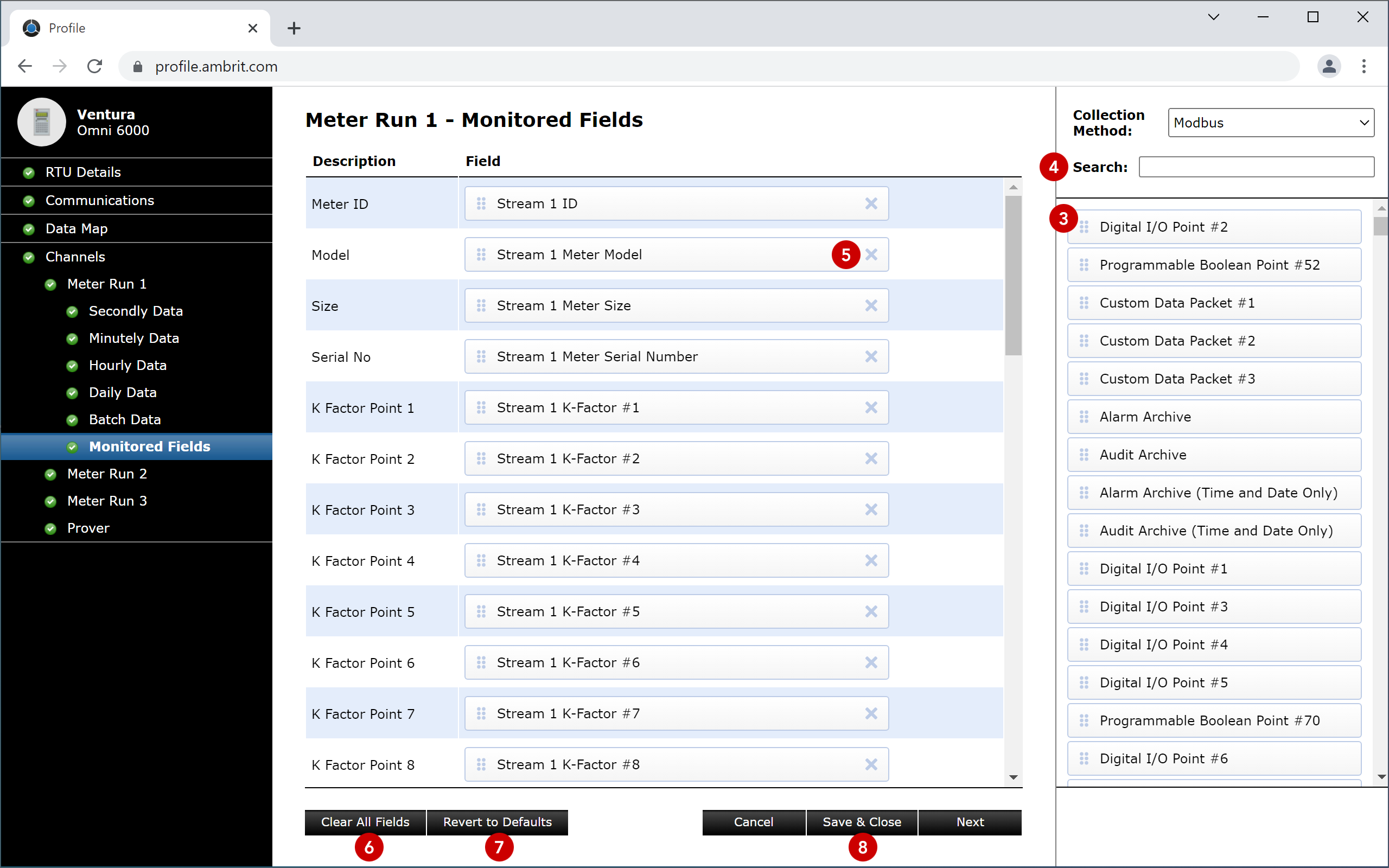

Each RTU has a list of predefined canonical fields. If the canonical field matches the field in the configuration it will be populated automatically:
To add or edit a field, drag and drop a new field from the right hand column. 3
The search box can be used to filter the list of fields in the column. 4
To clear a field, click the cross on the right hand side of the field. 5
To clear all fields, click the ‘Clear All Fields’ button. 6
To revert to the default fields, click the ‘Revert to Defaults’ button. 7
