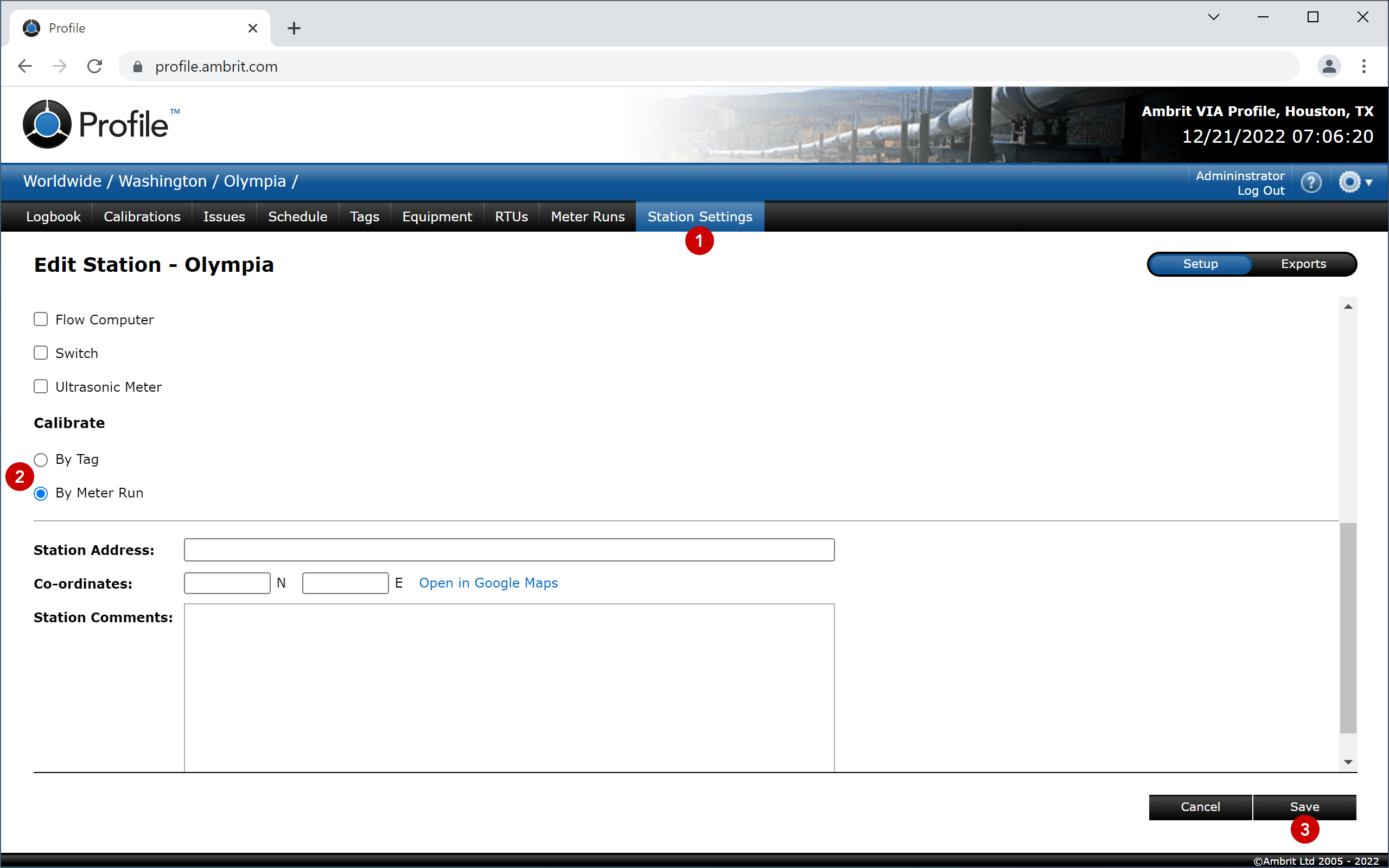

1. Navigate to the station
See the ‘Viewing a Station’ section for more details.
2. Click the ‘Station Settings’ tab in the Navigation Bar 1
The Station Settings screen will be displayed:
3. Select ‘By Tag’ or ‘By Meter Run’ in the Calibrate section 2
4. Click the ‘Save’ button 3
