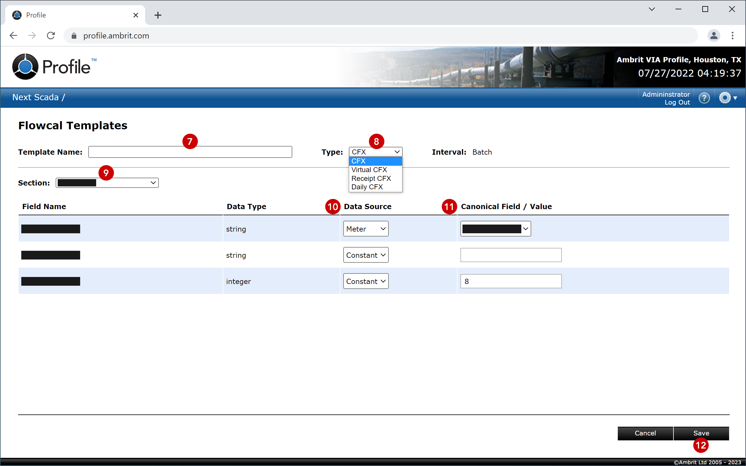

The template setup screen will be displayed:

The corresponding Interval will be displayed.
Each section will show a set of fields which can be configured.
The option selected in the ‘Data Source’ column will determine what can be specified in the ‘Canonical Field / Value’ column:
| Data | The value will be taken from the selected Profile historical data field. |
| Meter | The value will be taken from the selected field on the meter equipment screen. N.B. FLOWCAL equipment fields must be enabled in the Settings section. |
| Tank | The value will be taken from the selected field in the tank configuration. |
| Constant | A value can be entered manually. |
| Unused | Unused fields will not be included in the export file. |
N.B. Fields that are not needed in the export file should be set to “Unused” in the ‘Data Source’ column.
