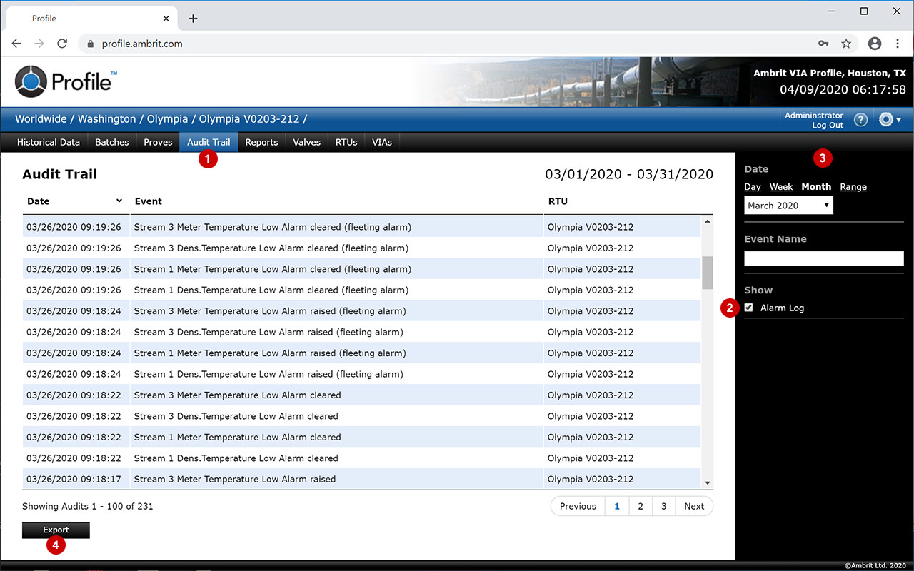

Viewing the Alarm Log
1. Navigate to the station
See the ‘Viewing a Station’ section for more details.
2. Click the ‘Audit Trail’ tab in the Navigation Bar 1
3. Tick the ‘Alarm Log’ checkbox to show alarms only 2
N.B. If data is being collected through a VIA and an alarm is raised more than once during a one minute period, it will be marked as a fleeting alarm in the list.
4. Filter the list as required: 3
  • Use the ‘Date’ controls to filter by Recent (most recent 100 alarms), Day, Month or a Date Range
  • Enter a keyword(s) in the ‘Event Name’ box
5. Click the ‘Export’ button to export the listed alarms to a csv file 4
