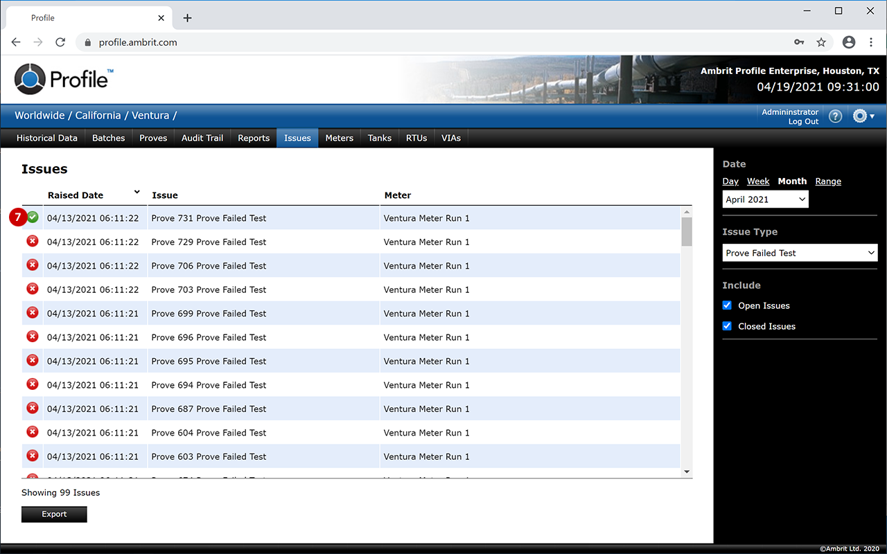

2. Click the ‘Issues’ tab in the Navigation Bar 1
This will show a list of all issues:
3. Filter the list as required: 2
  • Use the ‘Date’ controls to filter by Recent (most recent 100 issues), Day, Month or a Date Range
  • Use the ‘Issue Type’ drop-down menu to only show selected issue types
  • Tick the ‘Include’ checkboxes to only show selected issue statuses

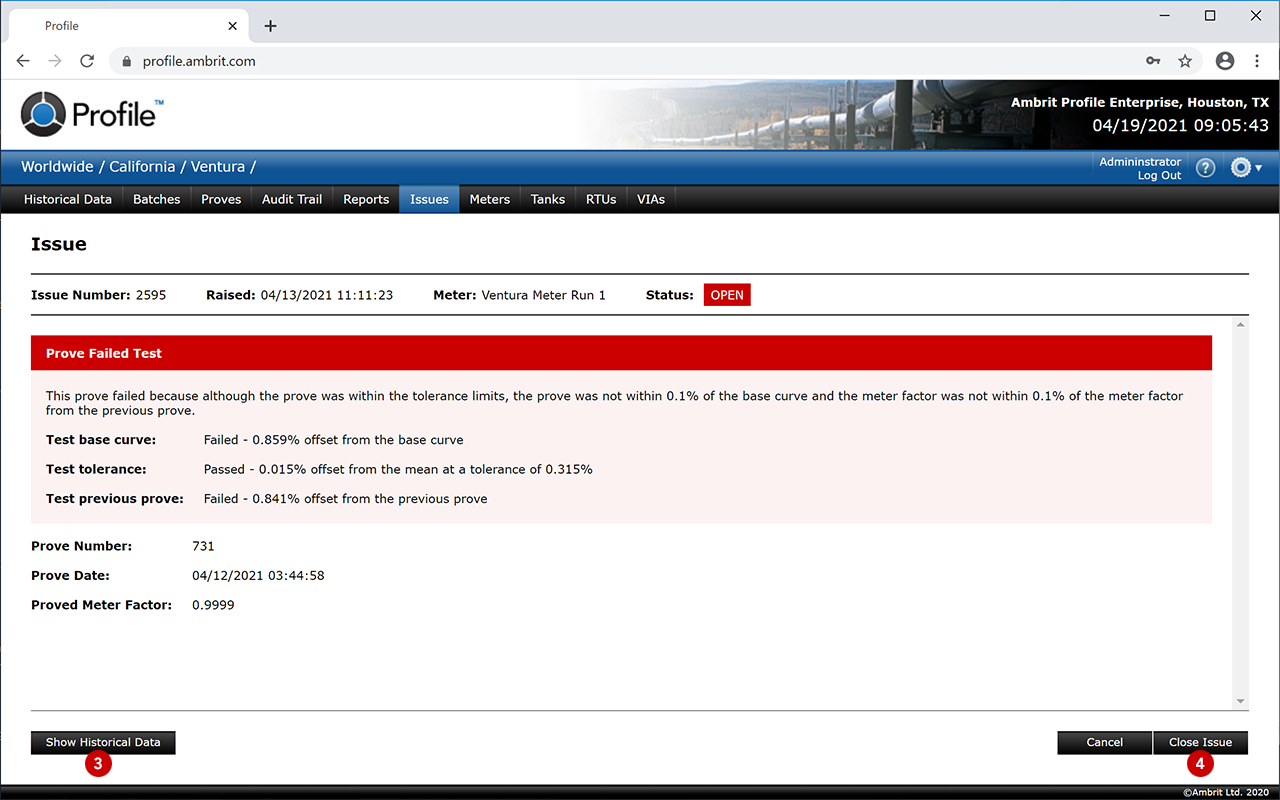

4. Double click on an issue in the list to open it
The issue data will be displayed:
5. Click the ‘Show Historical Data’ button to view the historical data at the time of the issue 3
6. To close out the issue, click the ‘Close Issue’ button 4

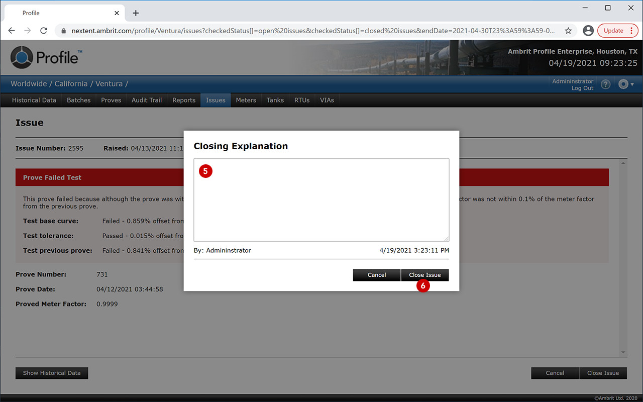

7. Enter a closing explanation 5 and click the ‘Close Issue’ button 6
The closed issue will be shown with a tick 7 in the list:
