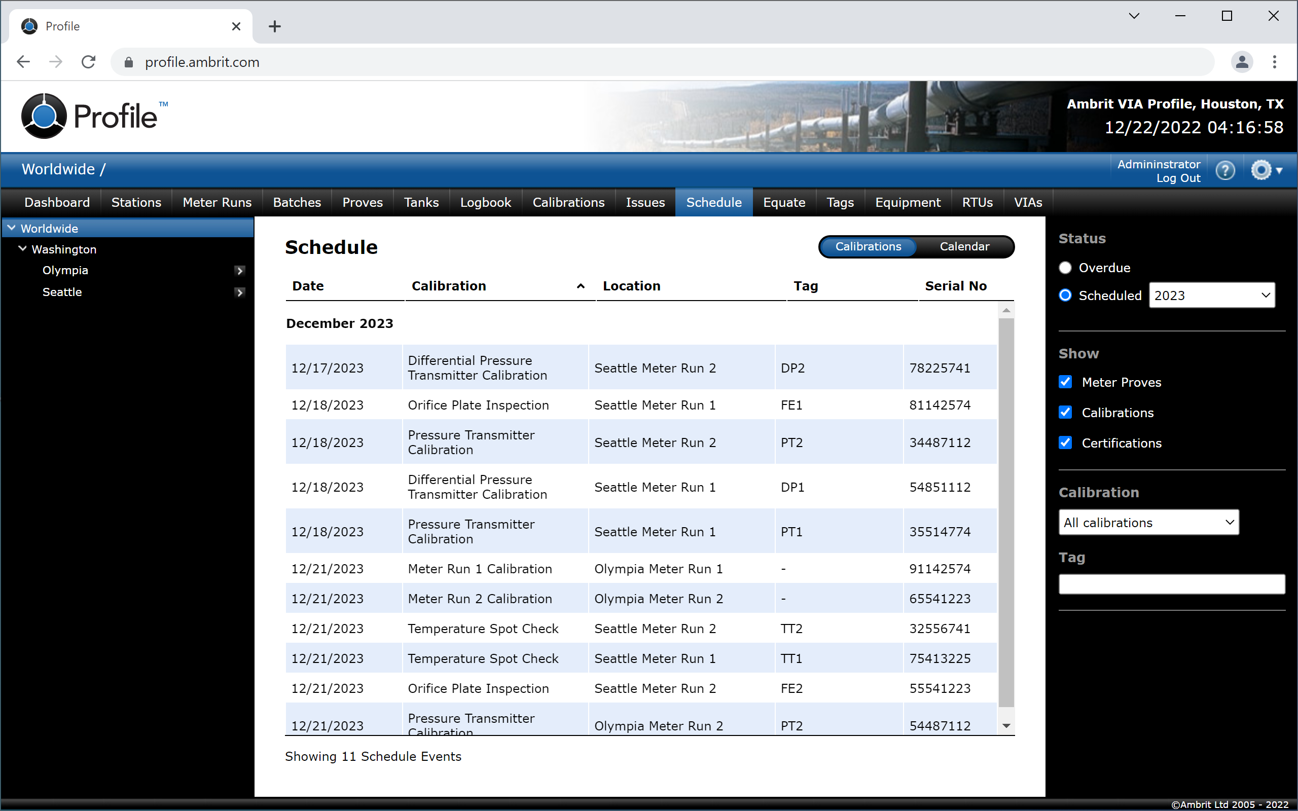

Upcoming calibrations will be shown on the Schedule. The schedule can be viewed at the worldwide level, for a selected area or for a single meter station.
The schedule displays calibrations each time they are due based on their frequency. For example, monthly calibrations will be shown 12 times for the year.
See the ‘Viewing the Schedule’ section for more detail.
