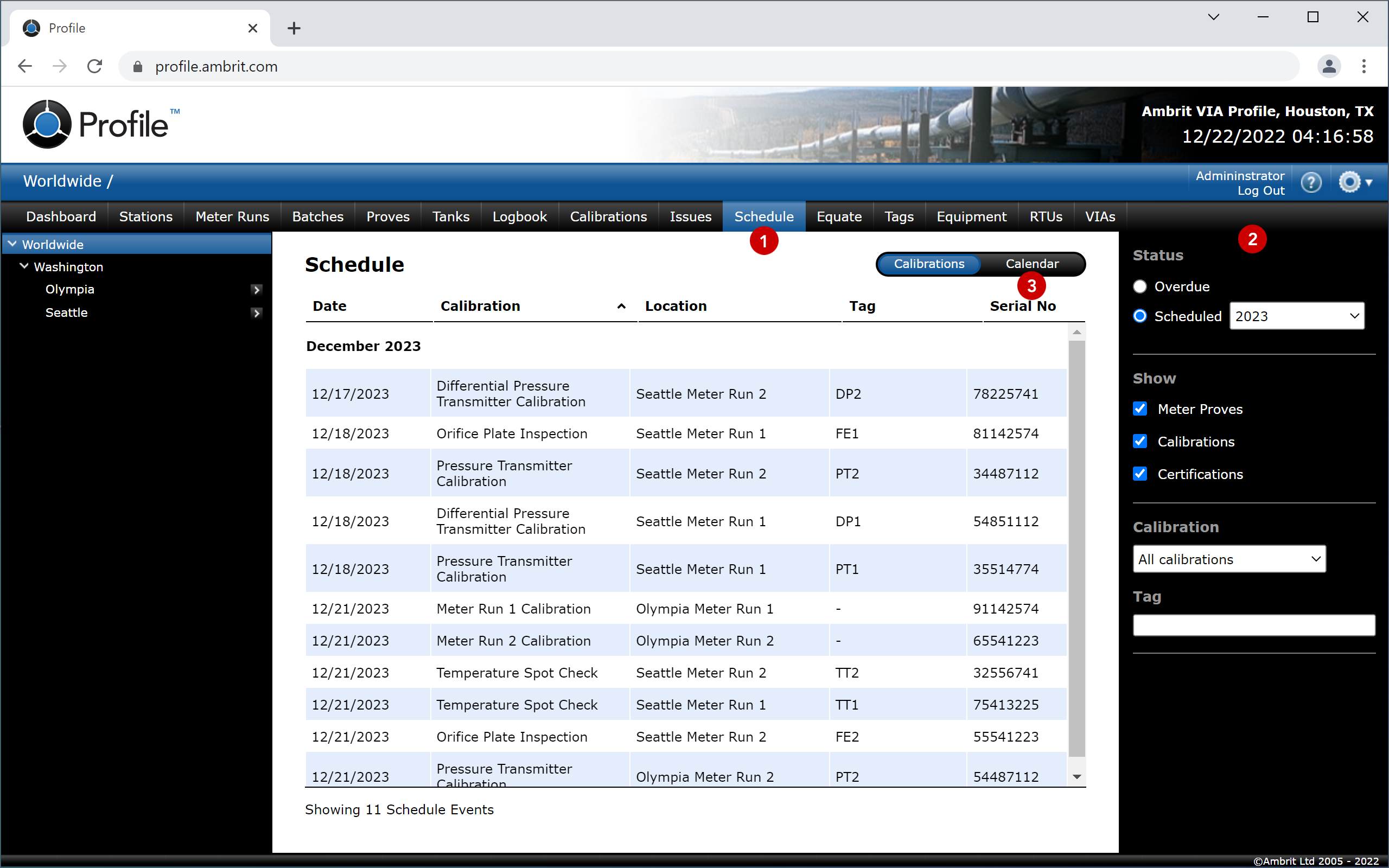

1. Click the ‘Schedule’ tab in the Navigation Bar 1
The Schedule is displayed:
2. Filter the list as required: 2
  • Use the ‘Status’ radio buttons to toggle between Overdue and Scheduled items. If Scheduled is selected, the list can be filtered further by selecting a period on the drop-down menu.
  • Use the ‘Show’ checkboxes to hide or show meter proves, calibrations and certifications
  • Use the ‘Calibration’ menu to filter by calibration type
  • Enter a tag name in the ‘Tag’ box
  • Use the ‘Location’ menu to filter by channel (only available in station mode)
Click on an item in the list to perform the meter prove, calibration or certification.

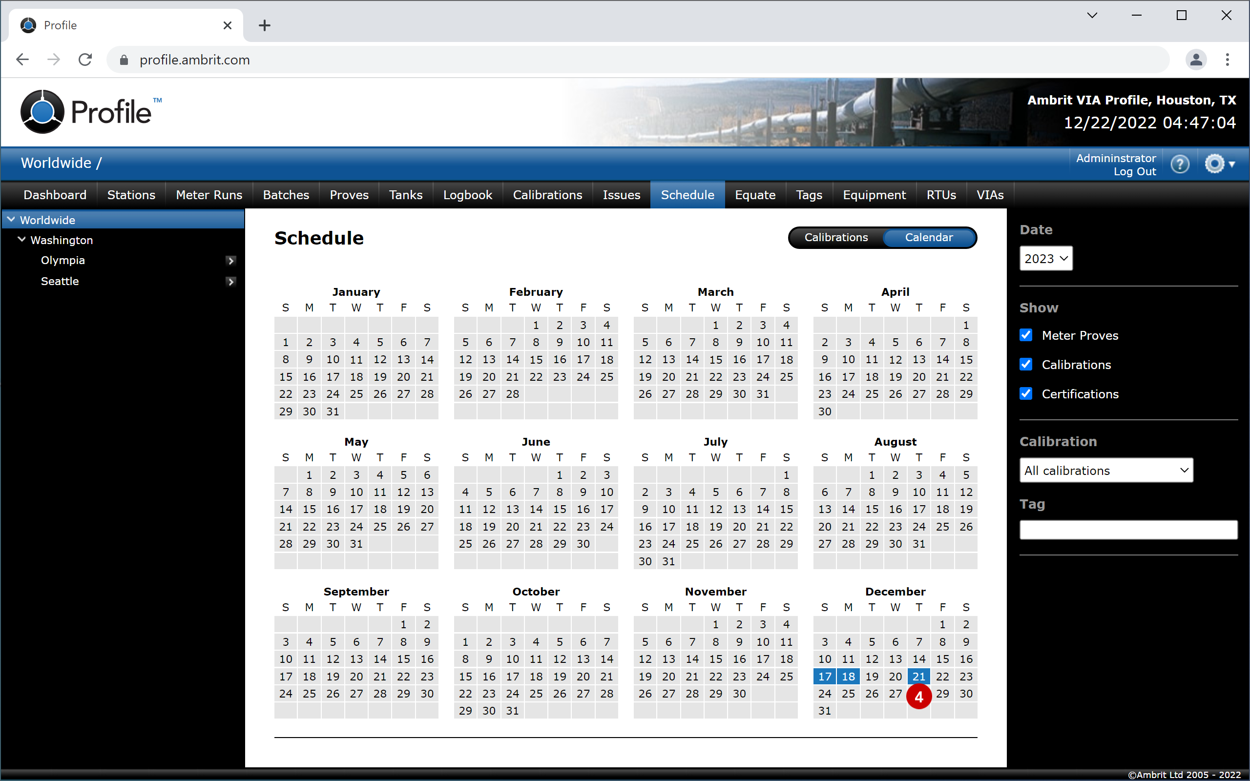

3. Click the ‘Calendar’ tab 3
The schedule is shown in calendar view. Days with upcoming meter proves, calibrations or certifications are shown in blue:
Schedule Calendar
4. Click on a day in the calendar 4

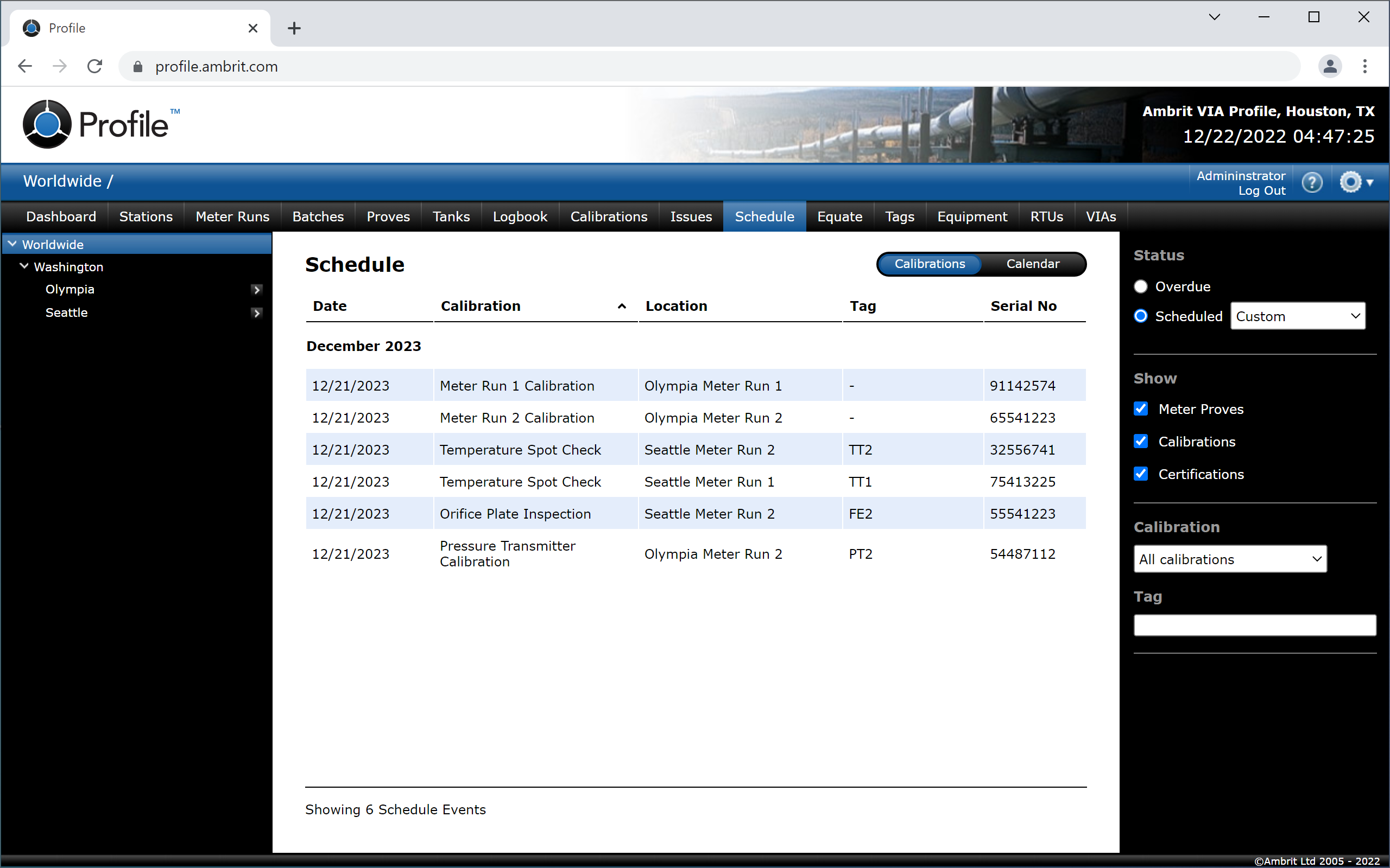

The meter proves, calibrations or certifications due on that day are displayed:
Schedule Custom
