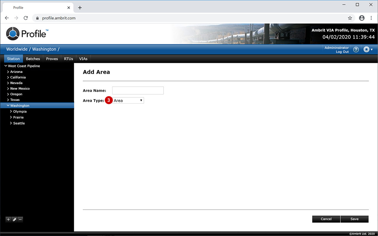

This will bring up the ‘Add Area’ screen:

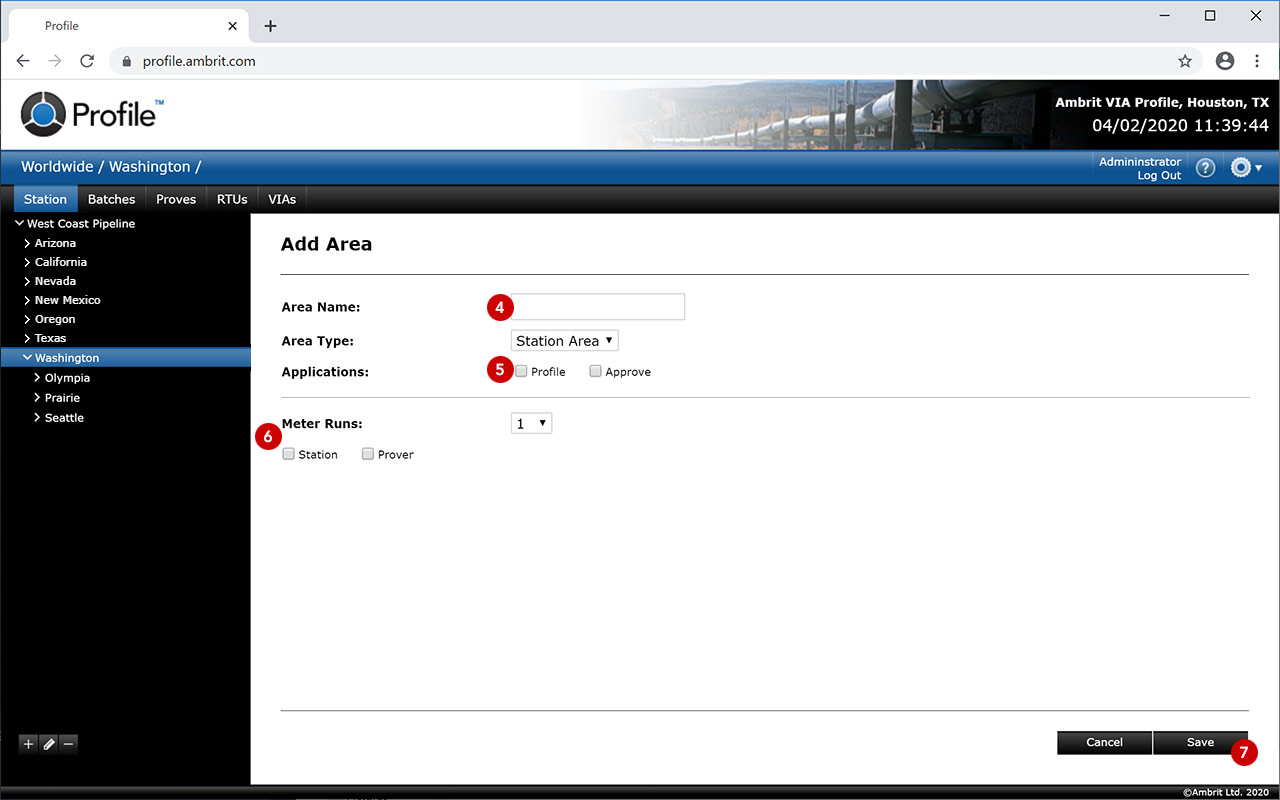

This will display the station configuration options:
N.B. Applications will only be visible if they have been purchased and activated in the key.
If the station is handled by a single stream RTU then this will generally be one.
Flow Computer Note: If the RTU is a multi-stream flow computer then extra options will be available for station and prover. If the flow computer has a station and prover built into it then tick these checkboxes.
The new station will be added.
See the ‘Adding an RTU‘ section for more details on how to add an RTU to a station.
