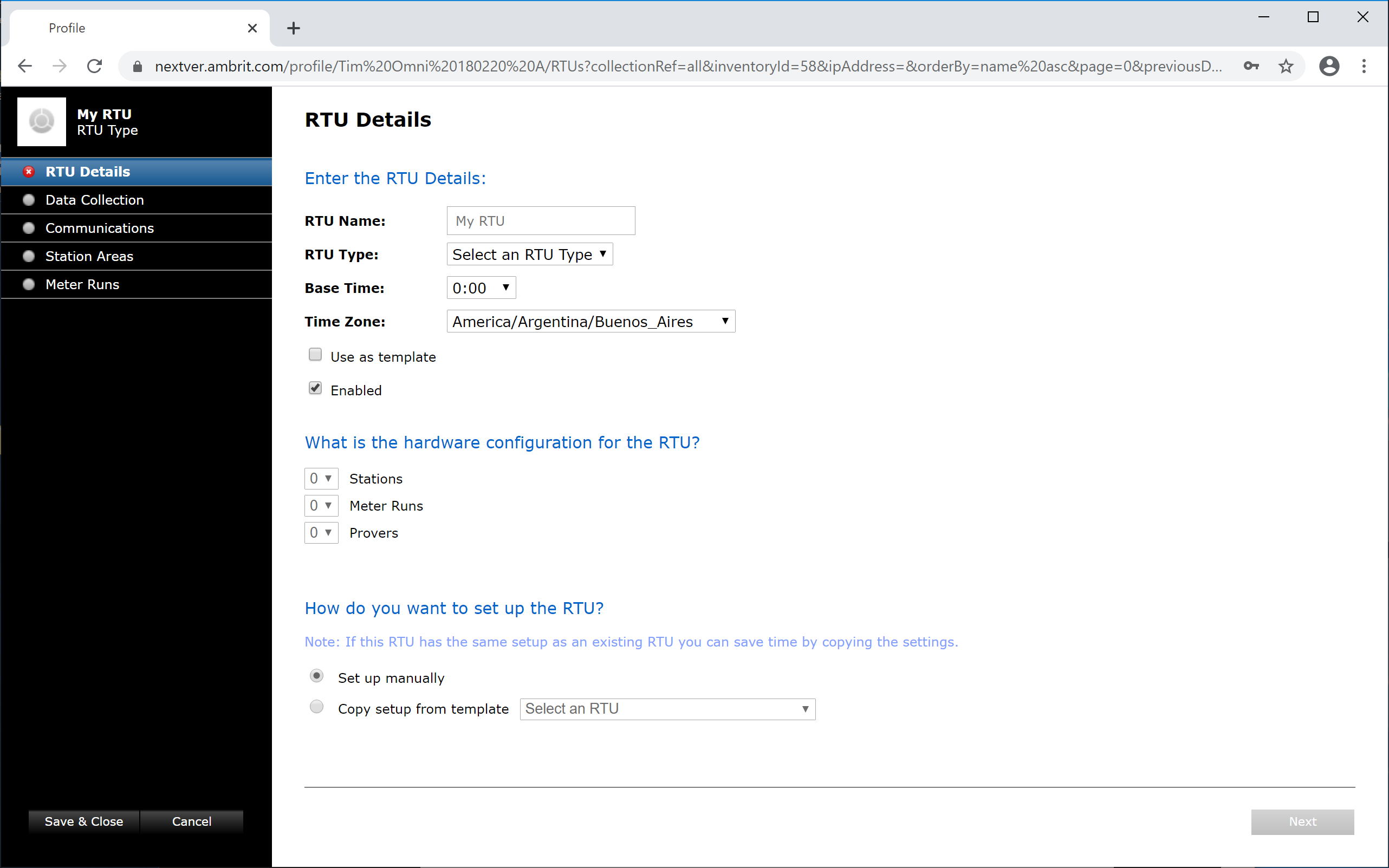

2. Click the ‘RTUs’ tab in the Navigation Bar
3. Click the ‘Add’ button
The RTU Setup screen is displayed:
RTU Details Blank
RTU Setup is split into five main sections which are shown in the sidebar of the screen and explained in the next sections of the manual:
Subsequent sections won’t be accessible until the mandatory information in the previous section has been completed, and the RTU won’t be usable until all the sections have been completed.
To navigate between sections, click the section name in the left hand column or click the ‘Next’ button. N.B. Subsequent sections in the sidebar won’t be clickable and the ‘Next’ button will be greyed out until the mandatory information in the current section has been completed.
