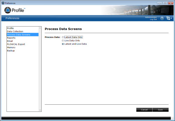

Note: Preferences can only be modified on the server and not through the web interface.
Latest Data Only | This turns off the live data screens to all users. Note: This will prevent any of the fields being edited! |
Live Data Only | This only presents live data mode only. Use this option if you have a fast connection to the RTUs |
Latest and Live Data | This option will show both live data and latest data. It will default to latest data mode whenever the process data screen is displayed. The user can switch into live data mode (if they have got access). This mode can potentially save costs by reducing how often modems need to connect. It will also give immediate access to the last data collected making the system more responsive in certain situations. |
