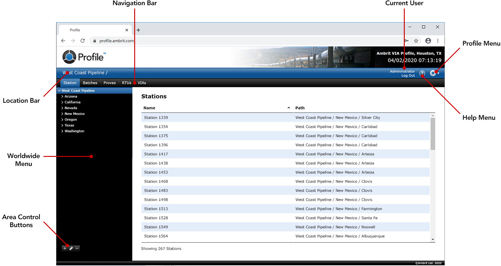

Profile manages remote RTUs at different locations and provides easy navigation to them using just a web browser.
The interface is made up of the following features:
Location Bar | The Location Bar shows the path to the currently selected area. Clicking any of the sub items in the path will take the user to that level. |
Navigation Bar | The Navigation Bar allows the user to switch between different views for the selected Area, including maps, Stations List, Overview, Global Alarms List and a list of RTUs. |
Current User | This is the name of the user who is currently logged in. Clicking the ‘Log Out’ button will log the user out of Profile. |
Help | This button will open the user manual. |
Profile Menu | This menu provides extended help and support options. It also allows the current user to be changed and provides a set of administrative functions that can be used to manage the users (if the user has the right level of access). |
Worldwide Menu | The Worldwide Menu provides a hierarchical list of areas that can be used to navigate around the system. |
Area Control Buttons | The Area Control Buttons allows the user to manage the areas in the Worldwide Menu. |
