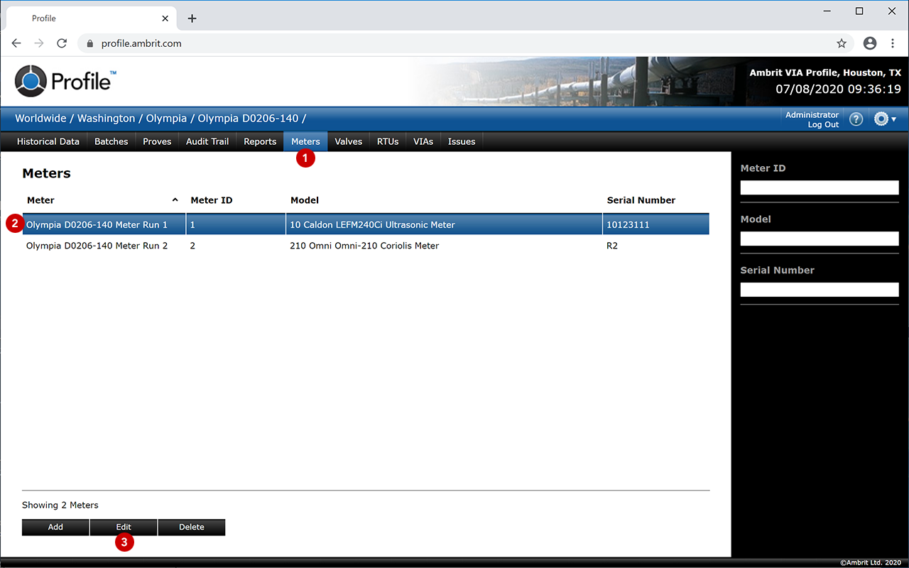

The meter details screen will be displayed.
N.B. You must have “Edit Meter” access level to edit a meter. Warning: Updating a meter will cause Approve to recalculate all prove data for the meter’s current base curve. This may affect the pass/fail status of the recalculated prove data.

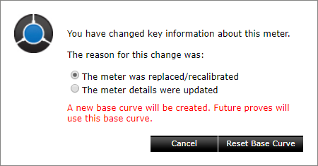

This will bring up a dialog asking for confirmation of the reason for the change.
If ‘The meter was replaced/recalibrated’ is selected, clicking the ‘Reset Base Curve’ button will cause a new base curve will be created. All old prove data will be archived and the future proves will use this base curve.
If ‘The meter details were updated’ is selected, clicking the ‘Recalculate Proves’ button will cause Approve to recalculate all prove data for the meter’s current base curve. This may affect the pass/fail status of the recalculated prove data.
